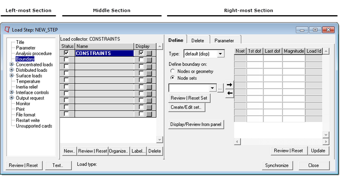

The Load Step dialog allows you to define the *STEP-*END STEP block as well as the associated Abaqus history keywords.  To open this dialog, double-click on the load step name in the Name: column on the Step tab or select the load step from the Name: column and click Edit. Options vary according to the active template. There are three vertical sections in this dialog.
left-most section
Contains a tree structure with various Abaqus history options. Selecting an option from the tree changes the dialog layout.
middle section
Contains the corresponding collectors in a table and relevant buttons to create, review, organize, reorder, rename, or delete these collectors. All loads must be organized into load collectors and all output requests must be under output blocks.  When you select a load type, output request type, or interface control from the tree, the load collector table, output block table, or interfaces table is displayed in the middle section.
right-most section
Contains the various tabs and options to define, edit, review, or delete the currently selected tree item. If the tree item needs to be organized in a collector (such as a load or output request), a collector must be selected from the middle section.
