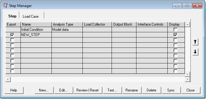

The Abaqus Step Manager opens when you load the Abaqus user profile and click Step Manager on the Abaqus Utility menu.  The Step Manager window is organized into two tabs: Step and Load Case.
The Step tab contains the descriptions of existing load steps with the corresponding analysis types, load collectors, output requests, and interface controls.  You can create, edit, review, rename, reorder, and delete load steps from this tab as well as set the export and display status of the load steps.
step_mgr_step_tab
See Step Manager Dialog Environment for tips on navigating through the dialogs.
The Step table contains the following columns:
Export
The export status of the load step. If the export status is on, the load step is written to the input file when exported from Engineering Solutions. If the export status is off, the STEP is not exported to the input file.
Name
The name of the load step.
Analysis Type
The analysis type of the load step.
Load Collector
The list of load collectors in the load step.
Output Block
The list of output blocks in the load step.
Interface Controls
The list of interface controls in the load step.  Interface Controls defines the following Abaqus keywords: Contact Pair, Surface Interaction, Contact, Contact Controls, Clearance, Contact Interference, Model Change, Change Friction, and Controls.
Display
Turns the load step display on/off.

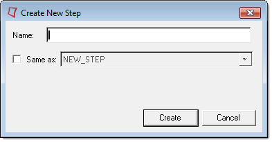

Opens the Create New Step dialog.  Enter the name of the new load step in the Name: text box and click Create to create the load step and open the corresponding Load Step editing dialog. The Same as: option allows you to create a new load step by copying from an existing load step.
