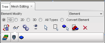

Beams, trusses and springs can be modified.
1. | From the Menu Bar, select Mesh Editing > Element > Modify. |
or
If the Mesh Editing panel is already open, select Element > Modify from the pull-down menu in the panel.
2. | Select the 1D radio button. |
3. | Click ![]() |
or
In the element list, click one element and click to display it in blue in the graphic window.
4. | Click ![]() |
or
Click to modify the element location:
• | In the graphic window, pick one node of the element. |
• | Next, pick another node to define the new node location. |
5. | Click Save to save the element modifications; or |
Click Cancel to cancel the element modifications.
6. | Click Close to close the menu. |
Beams, trusses and springs can be deleted.
or
2. | Click ![]() |
or
Click and in the graphic window, drag a box to select elements.
or
Click and pick parts in the graphic window. When finished, answer the question in the Dialog menu bar with Yes or Cancel.
or
Click and in the graphic window, drag a box to select parts.
3. | Click ![]() |
4. | Confirm the element deletion by clicking Yes or Cancel in the pop-up dialog window. |
5. | Click Close to close the menu. |
