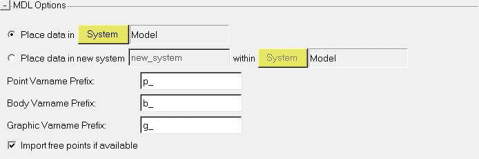

  8. Click the plus button next to MDL Options and review the various options.
    Note: The MDL Options allow for flexibility while importing. The CAD file can be imported either in an existing system/assembly or a new system can be created
  9. For this exercise, accept the defaults.

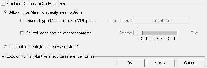

  10. Review the options under Meshing Options for Surface Data.
    Note: This section helps control the size of mesh (or tessellation). When the MBD model being created is used to solve non-contact problems, use the default option under Allow HyperMesh to specify mesh options. The Launch HyperMesh to create MDL points option allows you to select nodes in HyperMesh which can be imported into MotionView as MDL points. This is not needed for this tutorial since you will be creating these additional points using a macro. For models that involves contacts, it is recommended to use Control mesh coarseness for contacts. The Interactive mesh (launches HyperMesh) option can be used to mesh the surfaces manually. This is particularly useful when a finer mesh may be needed, such as in case of contact problems, to obtain better results.

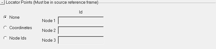

  11. Click the plus button next to Locator Points (must be in source reference frame) and review the options.
    Figure 3.
    Note: The Locator Points options can be used in cases where the CAD model being imported is not in the same coordinate system as the MBD model in MotionView. This option gives you control to specify three nodes or coordinates on the source graphic which can then be used to orient using three points in MotionView after it's imported. This option is not needed for tutorial as the imported graphic is in the required position.
  12. Select None.

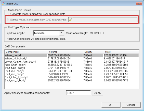

    The Import CAD dialog is displayed.
    Note: This dialog helps to generate mass and inertia information. The table displays different bodies or components being imported along with the volume and mass information based on a default density of 7.83e-6. The density value can be modified for each of the components. Alternatively, a CAD summary file can be used to extract mass/inertia
  14. Set Input file length to Millimeter.
  15. Under Component, select Wheel_body1. In the Apply density to selected components field, change the value of the density to 8.5e-7 and click Apply.
    Figure 4. Import CAD Dialog
  16. Leave the default value of the density for the other components. Click OK.

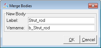

  2. Select Merge Bodies. This option is used to merge two or more bodies into a single body.
  3. From the Merge Bodies dialog, enter Strut_rod as the label and b_Strut_rod as variable name. Click OK.
    The three selected bodies are deleted and replaced by a new body with the label and variable names as entered previously. The mass and inertia values of this body are equivalent to the effective mass and inertia of the bodies being replaced.

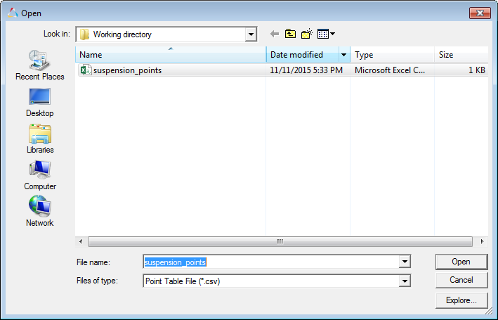

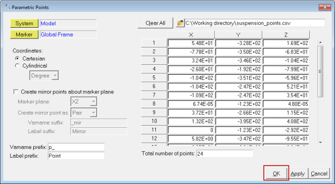

  2. Click to load a point table file.
    Figure 9.
  3. Select the file suspension_points.csv from your working directory.
  4. Click Open.
    All the point coordinates in the CSV file are imported into the utility.
    Figure 10.
  5. Specify Varname prefix as p_susp.
  6. Click OK.
    The points are added to the model. These extra points will be used for defining joints, orientations and other model inputs.

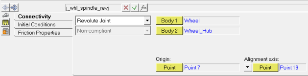

    The Add Joint or JointPair dialog is displayed.
  2. Specify the Label and Variable as Wheel Spindle RJ and j_whl_spindle_revj, respectively.
  3. For Type, select Revolute Joint.
  4. Click OK.
  5. Make the following selections:
    1. For Body1 of the joint, specify Wheel.
    2. For Body2, specify Wheel_Hub.
    3. For Origin, specify Point7. (Point around the Wheel center).
    4. For Axis, specify Point19. (Point around Axle Shaft center).
    Figure 12.
