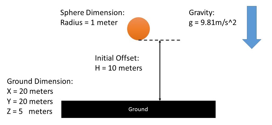

The image below illustrates the geometry and the values that you need.

For animation purposes, you can create a geometry object. In this case, a box representing the ground. According to the documentation, a box requires a center marker and its x,y,z dimension.
  1. Issue this command:
    In [8]: box=Box(cm=global_ref, x=20, y=20, z=5)
    You can similarly create the ball by first creating a part with mass and then creating a sphere located at the cm (center of mass) of the part. Inform the solver of the mass and cm of the part unless you are creating a ground part.

    radius = 1
    initial_offset = 10
    p = Point(0,0,radius+box.z/2.0+initial_offset)
