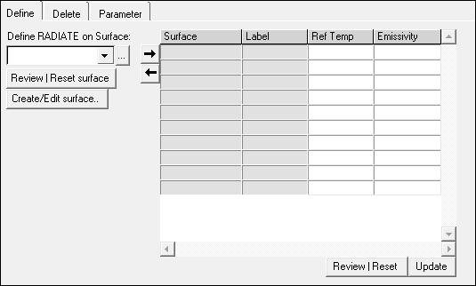

The Define tab allows you to define *SRADIATE card on Abaqus surfaces (*SURFACE).
Note:There is no graphical display in Engineering Solutions for loads created on Abaqus SURFACEs.  Therefore, when you review a load collector in the Step Manager, only loads created on individual entities are highlighted.  For loads defined on SURFACE, the underlying SURFACE elements are highlighted.

This dialog contains a Surface menu containing a list of the existing Abaqus surfaces.  It also has a table for data line input.  The table contains the following columns:
Surface
The name of the surfaces.  Surfaces are added and deleted in this column using ab-step-man-right or ab-step-man-left, respectively.
Label
The *SRADIATE labels.
Ref temp
Ambient reference temperature.
Emissivity
Surface emissivity.
The SRADIATE option has the following buttons:
Review/Reset Surface
Reviews the selected surface by highlighting them in the graphics.  Right-click on the Review button to clear the review selections.
Create/Edit Surface..
Opens a message with information about surface definition in Altair HyperMesh
ab-step-man-right
Adds the selected surface from the drop-down menu to the data line table on the right.
ab-step-man-left
Deletes the selected surface from the data line table.
Review/Reset
Reviews the selected surface in the data line table.  Right-click on the Review button to clear the highlighted selections.
Update
Updates the database with the data lines defined in the table.
For tips on entering information and navigating in the Define tab, see Step Manager Tab Environment.
