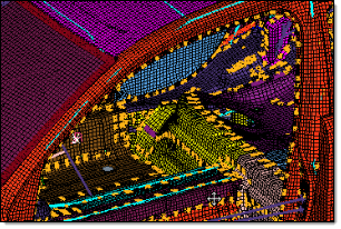

• | A value of 0 never filters labels, and can result in the text obscuring important parts of the model when zoomed out: |
The light orange "noise" is the text labels from many RBE3 connectors.

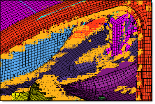

• | For values 1-10, higher values more aggressively filter out/hide the labels. (1 barely filters at all, while 10 filters unless zoomed in very close). |
Even when zoomed in quite close, the labels still do
not display when the value is set to 10.

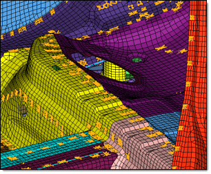

• | The default value is 3, at which level labels are filtered out unless zoomed in fairly closely: |
Even fairly close, text labels are still hidden.
Zoomed in a bit closer, text labels display.
