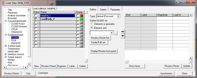

The Define DLOAD on: Element sets option allows you to define various DLOAD types on element sets.  The element set names are used in the *DLOAD data lines instead of the individual elements.  Unlike Abaqus surfaces in Engineering Solutions, you can combine element sets with individual element IDs in the same *DLOAD card.
Note:There is no graphical display in Engineering Solutions for loads created on sets.  Therefore, when you review a load collector in the Step Manager, only loads created on individual entities are highlighted.  For loads defined on sets, the underlying nodes or elements are highlighted.
step_mgr_define_elem_sets
This dialog contains a element sets menu with a list of the existing element sets.  There are two types of elsets in Engineering Solutions: components and entity sets.  The Abaqus elsets that are linked to sectional property cards (such as *SOLID SECTION, *SHELL SECTION, and so on) become components in Engineering Solutions.  Others become entity sets.  To differentiate between these two types, there is a divider line "- - - - -" in the elset list that pops up if you click the element sets menu.  The elsets listed below the divider line are components.
This dialog also contains a table for data line input.  The table changes depending on the DLOAD type selected.
The table contains the following columns:
For Default (Pressure) type:
Elset
The name of the element sets.  Element sets are added and deleted in this column using ab-step-man-right or ab-step-man-left, respectively.
Label
The labels of pressure load.  The available labels are: P1, P2, P3, P4, P5, P6, and P.
Magnitude
The magnitude of the load.
Load Id
The ID of the load collector.

The Define tab for Define DLOAD on: Element sets contains the following buttons:
Review Set
Reviews the selected element sets by highlighting them in the  graphics.  Right-click Review to clear the review selections.
Create/Edit Set
Opens the Entity Sets panel.  When you finish creating/editing the set, click return.  The Step Manager is updated with the new set appearing in the element set list.
Display/Review from panel
Opens the appropriate panel. Use the review button to expand the loads and constraints on the sets for visualization purposes.
ab-step-man-right
Add the selected element set from the pull down menu to the data line table on the right.
ab-step-man-left
Delete the selected element set from the data line table.
Show faces
This option is only shown for Default (pressure) type.  It is mainly used to review the face identifiers of elements in the selected set.  It creates a temporary skin of the selected elset, opens the Element Selector panel, and allows you to pick face elements from this skin.  When you return from the element selector panel, the selected faces display color-coded face identifier tags.  In performance graphics, these tags are sometimes blocked by the solid mesh.  You may need to rotate the model a little to view the tags.
Right-click the Show faces button to clear the face review.
Define by vector
This option is only shown for Gravity type.  It opens the Vector Selector panel. Pick a vector and click proceed.  This vector is used to define the Comp1, Comp2, Comp3, and Magnitude of the gravity load for the selected element set.
Create/Edit vector..
This option is only shown for Gravity type.  Opens the Vectors panel.  When you finish creating/editing the vector, click return.
Review
For Default (pressure) type.  Creates special review pressure loads in the Engineering Solutions graphics for the selected set.  For other types, it reviews the selected element set.  Right-click the Review button to clear the special review loads and highlighting.
Update
Updates the Engineering Solutions database with the data lines defined in the table.  By default, Engineering Solutions does not create a display for loads defined with sets.
